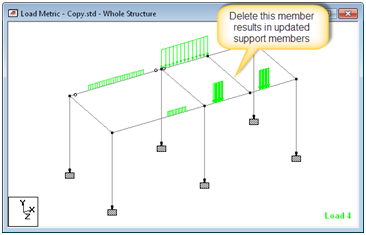

Updated model with cross member deleted, support beams combined:

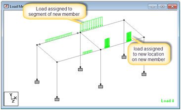

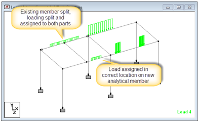

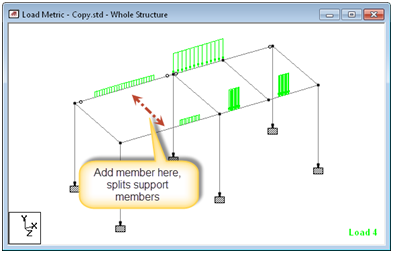

Add a member that divides existing members:
Analysis model updated:
