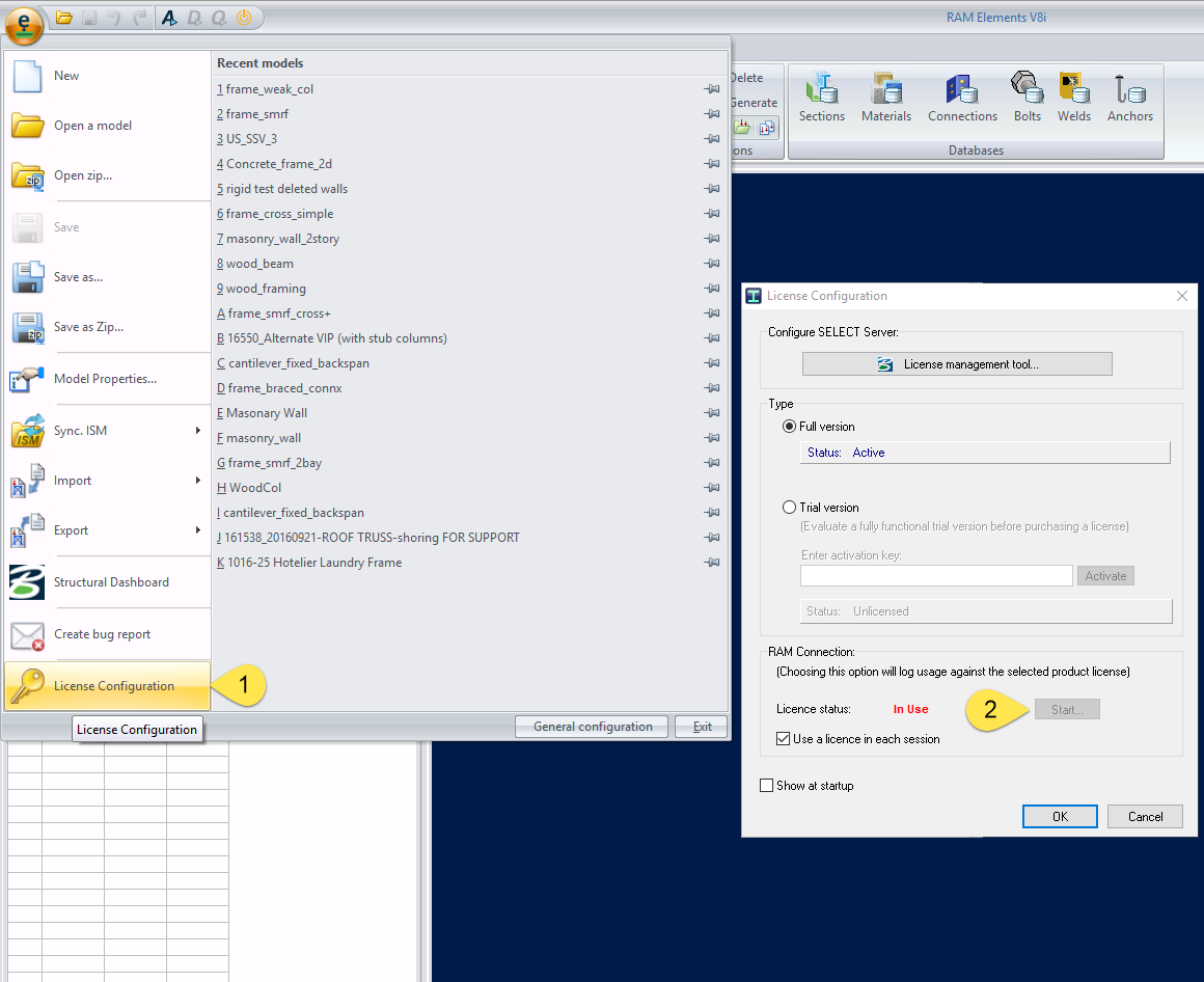

Ram Connection for Ram Elements has been installed, but the connection tool bars and features are missing from Ram Elements.
Steps to Resolve
  1. Open the 'e' menu in the upper left. and click License Configuration in the lower left corner.
  2. Then click the Start button in the section labeled "RAM Connection" or check the option to "Use a license in each session".
  3. Click OK to save changes.
RAM Elements will enable the RAM Connection integration features.
Converse
If you don't want to use a Ram Connection license or want the Ram Connection features to be available in Ram Elements then uncheck the box that indicates to "Use a Ram Connection license in each session".
Ram Elements should then be restarted.
