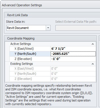

  1. Use the Update From Repository command. When the ISM Revit Link dialog opens click on the Advanced button at the bottom of the dialog.
Enter the dimension you took earlier. Note any large dimensions may need to be entered as inches if it will not accept feet and inches.
