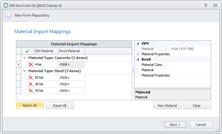

When the Material Import Mappings dialog opens the red X’s next to each of the material types indicates they are not mapped. You can click the Match All button and the material will be matched to the ISM materials.

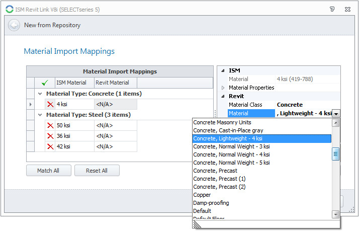

If you want to map the material to a Revit type material, select the material in the left pane and then select a material type from the drop down in the right pane.
Repeat the process for each material type.

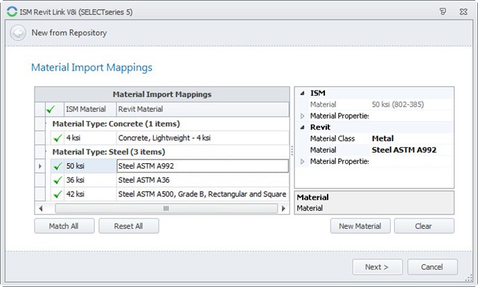

After all of the material is mapped click the Next button. The next mapping dialog that opens is the Column/Framing Section Import Mappings. That will be covered in a separate article.
