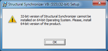

Can't Install the 32-bit Version on a 64-bit Operating System
  Product(s): Structural Synchronizer
  Version(s): 8.11.11.46
  Environment:  64 bit OS
  Area:  Installation
Problem Description
Users are unable to install Structural Synchronizer V8i SELECT series 5 version  08.11.11.46, getting a message that indicates, "32-bit version of Structural Synchronizer cannot be installed on 64-bit Operating System."

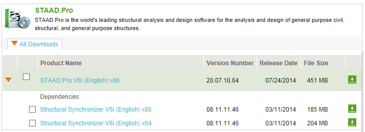

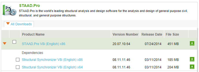

There are 2 installers for Structural Synchronizer that can be downloaded and installed from My SELECT CD or the Fulfillment center. Only the 32-bit version (x86) can be installed on 32-bit operating systems, and only the 64-bit version (x64) can be installed on 64-bit operating systems.
When downloading some products that list Synchronizer as a dependency, the listed version of Synchronizer may not be the matching one for the computer where it's being installed.
