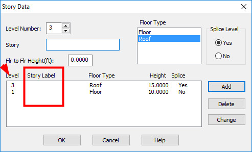

What to look at if you create an ISM repository from a RAM Structural System model and none of the framing for any story is not exported. (Beams, Joists, Columns, Bracing)
You can get the following errors when the shapes are not being exported.
ISM Plugin for RSS log file
Product Version: 15.03.00.01
Error Messages
   An error occurred during the export of a column (Error message: Object reference not set to an instance of an object.)
      Element Id: 9901
      Element Id: 10001
Open RAM Modeler and inspect the story data. If you are missing story labels or story levels skip a level those stories may not be exported.
Add a Story Label for each Floor Type and adjust the story Level numbers so that there are no gaps.
