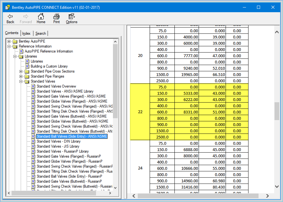

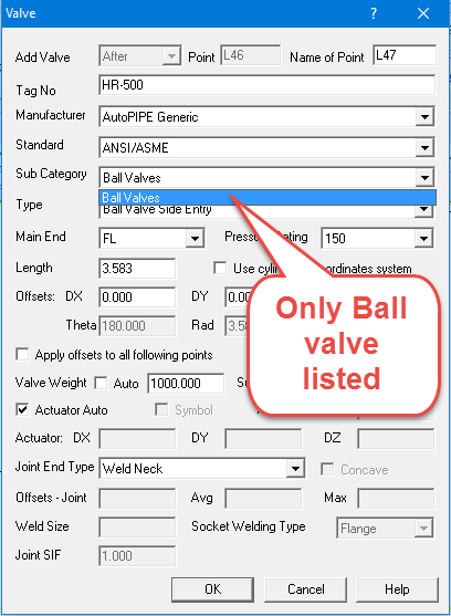

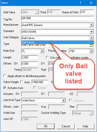

Example #1:
Pipe size = 22 inch dia.
Type of valve available was only Ball valve
Why?
Answer:

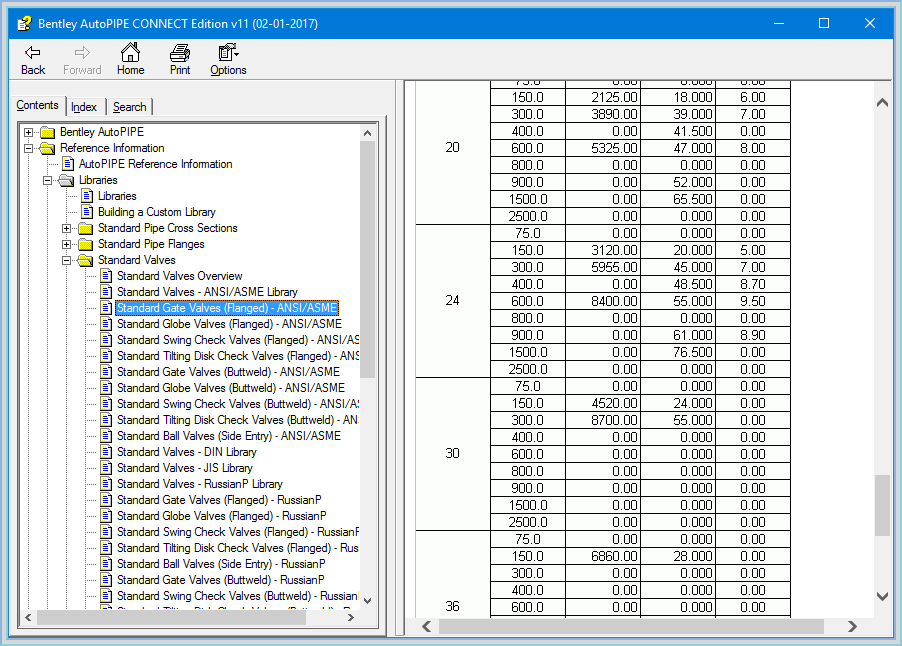

From the Valve dialog select "Help" button,
> Valve Type hyperlink,
> View Standard Valves in Library hyperlink
> ANSI/ASME Library
> Standard Ball Valve (Side entry)
Note, 22 inch valve library information was available for a ball valve.

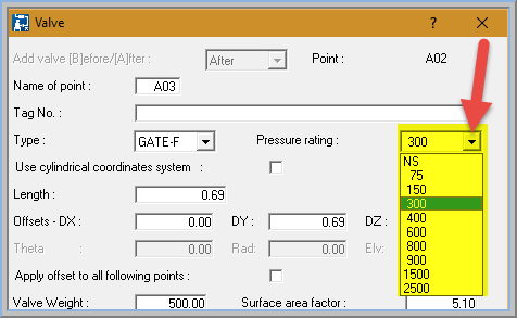

However, NO 22 inch valve library information was available for a Gate valve. Thus Gate valve was not an available selection on the valve drop down listing image above.

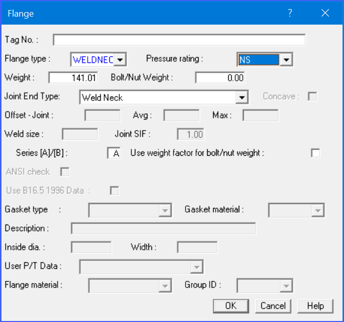

Example #2:

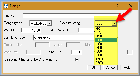

Pipe size = 100 inch dia.

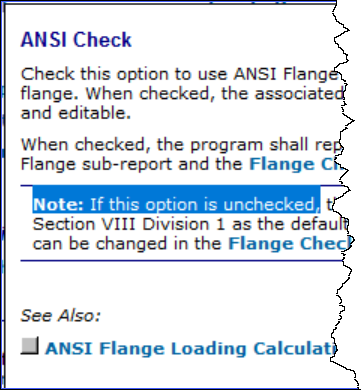

No Flange Pressure Rating and ANSI Check is greyed out
Why and how to avoid?
Answer:
Again, see AutoPIPE help for library information available for flanges of that pipe size. Note, there was no library information available for flanges of that pipe size. Thus the only option would be to set the Pressure rating to NS.
The ANSI flange check was greyed out because library information was not available. Please see AutoPIPE help on this setting what to do when this option is greyed out / unchecked.

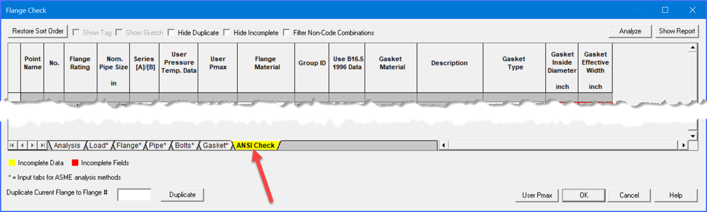

Note, when using the Flange Check utility be sure to update the ANSI Check tab as needed before analyzing the flange on the Analysis tab.

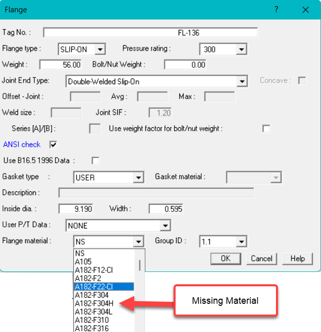

Flange material missing from drop down listing on flange dialog.
Answer:
This drop down listing button retrieves library data from the the Flange Check> ASME Material library (asme2010.db).
Use steps below to add a new material to this
1. Open the asme2010.db File
- See Knowledge Base (KB) article here for steps to open and review this library.
2. Add a New Material Entry
There are two main approaches:
- Copy / Paste / Modify an existing Material
- Add a new material from scratch
a. Copy / Paste and Modify an Existing Material
- Open database file
- Review Table = B16_5_Table_1A
- Find a material in the database similar to the one you want added.
- Copy the entire row for that material and paste it as a new row at the bottom of the listing.
- The ID should have been increased by 1 for each record added.
- Modify the remaining 5 columns of material data fields in the table as needed for your new material.
- Note, no records should have identical data across 4 or more columns.

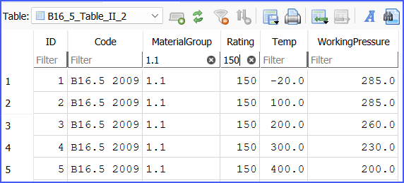

3. Add data to table II_2
- Record the values used for the following in table B16_5_Table_1A:
- Change to Table = B16_5_Table_II_2
- This table is used to continue entering related flange material information for each new record added in Table 1A above.
- Perform a general review of this table, paying particular attention to how entries are added. These two tables are linked by the columns Code and MaterialGroup. As can be seen, the following additional data must now be added to Table 2 for each entry in Table 1A:
- Flange Rating Range
- Temperature Range
- Working Pressure
- When ready, add the required records for each flange rating, including every applicable temperature for the rating, and its corresponding working pressure.
- Example:
- Repeat as needed for each flange rating for each unique Code - Material group combination from table 1A
- Check all entries that have been added. No record should have 4 or more columns with the same information.
- Verify again, look for added spaces or character that are not supported in the related field.
- Perform a final verification.
- Ok, go to Save and Verify step below.
