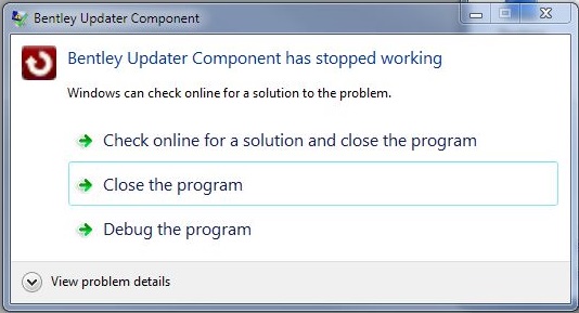

The ISM Viewer application crashes when started reporting a problem with the Bentley Updater Component.
Update to SELECTseries 5 release 8.11.11.50 manually
