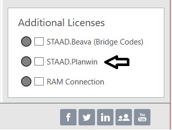

I have been accidentally using STAAD Planwin / Building Planner module. How do I deactivate it?
Starting with STAAD.pro SELECT series 6, the Planwin functionality is built into the STAAD.pro installer. To deactivate it, make sure that the Building Planner is unchecked in the initial screen of STAAD.Pro.
In STAAD.Pro CONNECT Edition, you will find this in the bottom of the window at the right-hand corner.
In STAAD.Pro V8i edition, you will find a dialog box for License Configuration, similar to the one here.
