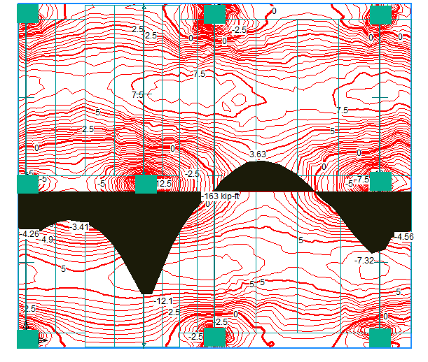

When should design strips be modeled with column and ½-middle strips and when should they be modeled as full-width column strips?
RAM Concept uses a finite element analysis to determine design forces. These forces are determined by integrating (or averaging) the finite element forces across the width of the column or ½ middle strips. The wider the strip, the more the design force is averaged and the greater the difference to the peak design force in the strip.
Figure 1 shows a typical moment distribution. Note that the moments are highest near the column and decrease toward the middle of the span. Using the column/middle strip approach forces the program to integrate moments with similar magnitudes across the width of the strip. The design moment for the column strip will be closer to the peak moment than if a full-width design strip was used. It is important to remember that the use of column and middle strips only affects the integration of forces, but does not affect load distribution in the finite element analysis.
 Figure 1. Typical Moment Distribution Across Column and Middle Strips

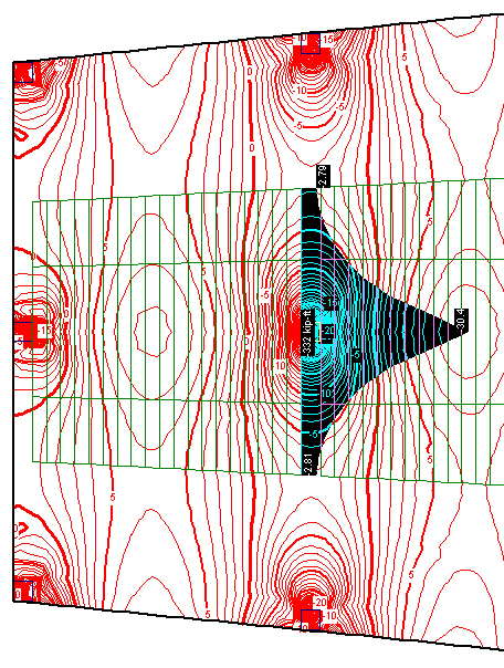

In some cases, it may be desirable to use design strips modeled as full-width column strips instead of column and two half middle strips. If two columns are close together, for example, the moment distribution may not vary significantly over the width of the strip (see Figure 2). Averaging moments over the full tributary width may be justified.
 Figure 2. Typical Moment Distribution for Closely Spaced Columns

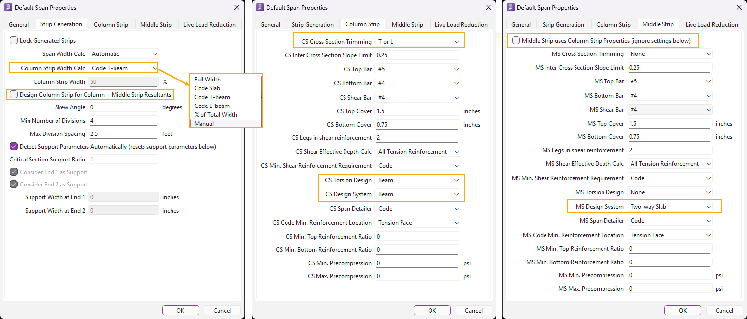

Typically, design strips for beams have the Column Strip Width Calc set to “Code T-Beam” (See Figure 4) and the CS Design System set to “Beam” in the Strip Generation tab (see Figure 4). This ensures that the column strip includes the beam and its effective flange width and that the cross-sections are designed using the ACI provisions for beams as opposed to slabs. The Middle Strips tab will typically have the box for “Middle Strip uses Column Strip Properties” unchecked (see Figure 4). This allows for the beam and slab to be designed with different bar sizes. The MS Design System should be set to “Two-way slab” so that the code provisions for slab design are used for design (see Box 5 in Figure 6).
When modeling one-way slabs, it is convenient to use the “Design Column Strip for Column + Middle Strip Resultants (See Figure 4). When selected, forces are integrated separately over the column strip and each half middle strip, then added together, and used to design the column strip. This allows for the beam and its effective flange to be designed for the full design strip forces.
Figure 4. A - Typical Strip Generation Settings for Beam Design Strips
     Box 1. Option for manually defining support widths
     Box 2. Option for setting column strip width calc to "Code T-beam"
     Box 3. Option for designing column strip for column + middle strip resultants
Figure 4. B - Typical Column Strip Settings for Beam Design Strips
Figure 4. C - Typical Middle Strip Settings for Beam Design Strips
     Box 4. Option for choosing different properties for middle strips
     Box 5. Option for selecting design system for middle strips

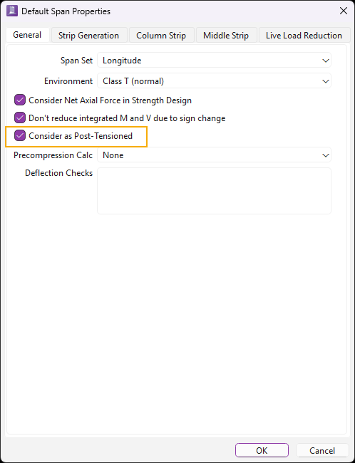

Why does the Status Plan on the Design Status Layer show failures for ACI 318 18.3.3 (or other post-tension concrete code provision when the slab is a mild reinforced concrete slab and not a post-tensioned slab?
There is an option in the Default Span Properties dialog that controls whether the design strip is designed as a post-tensioned slab or a mild reinforced slab (see Figure 7 below). To change the setting for span segments that have been modeled previously, do the following:
  1. Open the Latitude Design Spans Plan on the Design Strip layer.
  2. Use the Selection Tool to select all span segments on the plan.
  3. Right click in the plan window and choose "Selection Properties" from the menu to open the Default Span Properties dialog.
  4. Click on the General tab.
  5. Uncheck the box for "Consider as Post-Tensioned" (see Figure 5).
  6. Repeat steps for the Longitude Design Spans Plan on the Design Strip layer.
  7. Reanalyze model.
Figure 5. Consider as Post-Tensioned Option
