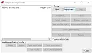

  2. Go to the menu > Analysis and Design > A & D Models…
  3. Click Import New

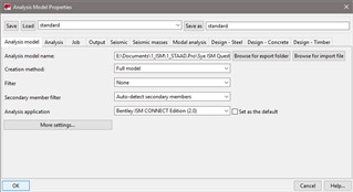

  4. Browse to the ISM repositories location and select the model and click OK.

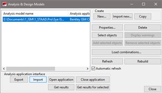

  5. Click Import

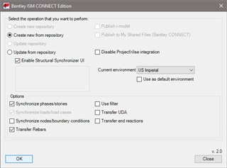

  6.  If not already selected, pick "Create new from repository" select the environment and any other options. Click OK.
  7. In the dialog that opens, browse to the ISM repository you want to import and open it
  8. When Structural Synchronizer opens all of elements in the model will be set to Added and Accepted. Click Update to create the repository.
  9. After the model is imported click Cancel in ISM Synchronizer and Close in the Analysis and Design Models dialog.
