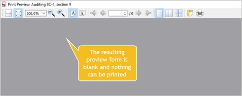

Problem Description

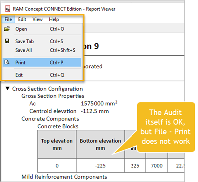

In Ram Concept version 06.04.00.006 when using the Cross Section Audit tool or the Punching Check audit tool, the File - print function brings up a blank print preview window and nothing is actually printed.
Reason
The printing of html formatted content was broken in a shared component that we use for audits (Qt). The issue is being corrected, but beyond our direct control.
Until there is a better solution, use the File - Save Tab (or Save All) function to save a copy of the audit in .html format. Then open the resulting auditXX.html file using any browser or word processor and print from there.
Alternatively the data in the Audit screen can also be copied to the clipboard and pasted to another type of document, but formatting is adversely affected this way.
