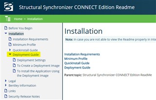

  1. Download the standard installation of Structural Synchronizer (You can find that by searching Software Downloads)
  2. Right click the downloaded installation file and select "Run as administrator". When the first dialog opens click the question mark in the upper right corner to open the Help file.
  3. When the Help file opens select Deployment from the table on the left side. There you will find all of the information and options for creating a Silent Install deployment.
