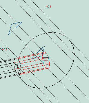

1. It is not advisable to make the header rigid; only the branch running from A01 to B02 should be made rigid. At the Tee node point A01, recommend setting Tee Type = Other and to enter a SIF = 1.0, as the SIF is transferred to the connection point at B02. Upon reviewing the results, it was noted that no stress was calculated on the tee header. AutoPIPE will disregard stress on rigid pipes, confirm the setting for Tools > Model options > Results > “Show rigid tee stress”.
2. When modeling a fitting (Weld On), insert a node point at the precise location of the branch piping connected to the fitting. At this connection node point, use AutoPIPE command to Insert > Xtra Data > Joint type and set User SIF > Joint End Type (select the appropriate end type connection). This procedure will ensure that the fitting (Weld On) connection is accurately represented.
3. This two-node tee modeling approach places the tee flexibility at the centerline intersection while locating the branch connection at the header OD using a weightless rigid offset. The benefit is that it better represents the physical branch attachment location and avoids adding non-physical pipe weight / flexibility inside the header, while still allowing thermal growth across the offset.
An additional consideration is that the rigid offset alters how loads are transferred between the tee and branch. This can result in small differences in local tee rotations and moment distribution compared to a traditional single-node representation. For most piping systems, the impact on global displacements, support reactions, and code stresses is typically minimal, with any noticeable differences generally limited to local tee behavior and heavily loaded short branch connections.

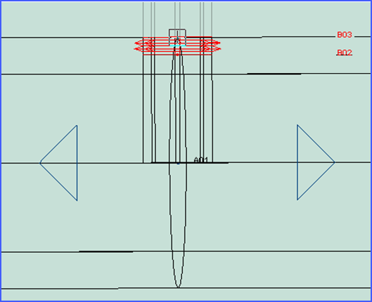

Method #3 - 3 point model
Large bore header, large bore branch (including the pipe wall flexibility). This method can also be applied to small bore pipe branches, if desired.
Note:
1. The data for the flex joint will be determined in the steps below.
2. Point 3, B03, is at the header pipe OD radius or surface of the pipe.
Note
1. AutoPIPE cannot determine the in-plane or out-plane SIF values for “point 3” since it is not an elbow or tee point. See step #2 from Method #4 below for procedure to apply the SIF and flexibility values.
3. The 3-point modeling approach provides the most physically representative approach by separately accounting for branch attachment geometry, header wall flexibility, and local stress intensification effects. While it requires additional modeling effort and user-defined flexibility/SIF inputs, it can provide a more realistic assessment of local branch connection behavior, particularly for large-bore headers, reinforced connections, and heavily loaded branch attachments. For applications where local load distribution is important, this approach offers the highest level of fidelity among the three methods.

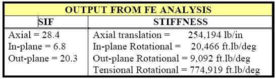

STEP 1: Run FE analysis and record output. An example is shown below.
Table 1: Output from FE Analysis (converted to correct units for AutoPIPE)

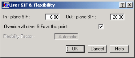

STEP 2: Input In-plane & Out-plane SIF’s. As a first guess, you may input SIF’s in the same order as outputted by FE analysis.
Fig. 1: AutoPIPE SIF input window

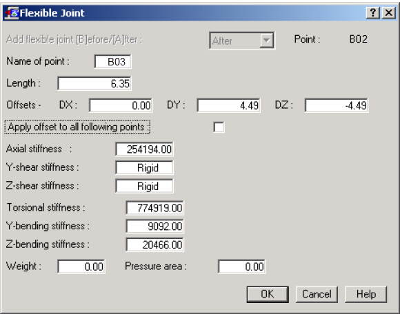

STEP 3: Using the procedure described above, input the corresponding flexibilities from table 1 into AutoPIPE
Fig. 2: Flexible Joint Input window from AutoPIPE

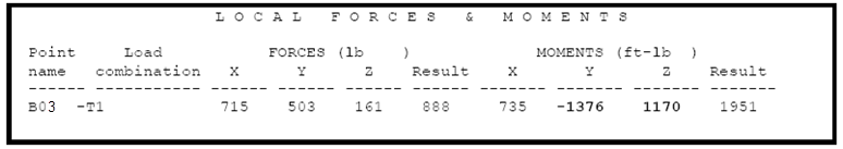

Prior to generating a report in AutoPIPE, open Results Model Options dialog, set Force (Global/Local) = L.
Create a “Result / Output report “ that includes Forces & Moments and Code Compliance (remove / add other subsections as needed).
Optional: Before generating a report, highlight parts of the piping system and use Report Option “Limit reports to highlighted points” for a focused information.
In our case, node B03 is our “point 3”, and we have previously figured out that the local z axis is the in-plane direction; therefore 1170 is the in-plane moment. Similarly, the local y axis is the out-plane direction, so 1376 is the out-plane moment.
Table 2: Local Force & Moment table from AutoPIPE Output

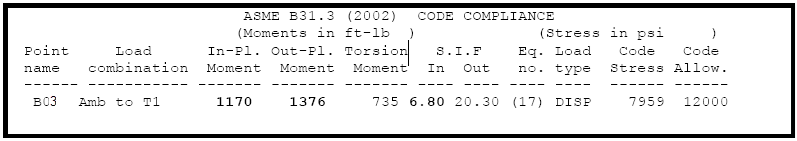

STEP 5: Look at code stress and determine if the in-plane moment 1170 is being multiplied by the correct SIF of 6.8, which is our in-plane SIF. (Be aware that the in-plane and out-plane moments we determined in the previous step might not be listed under the In-Pl. and Out-Pl. columns in the Code Compliance report, since AutoPIPE is ‘guessing” about which one is which! The important thing is that the numbers match up.) Are the SIF directions correct? If they are not, go back to step 2 and reverse SIF directions. In this case SIF of 6.8 matches the in-plane moment of 1170, and the SIF of 20.3 matches the out-plane moment of 1376, so our assumption in step 2 was correct.
Table 3: Code Stress from AutoPIPE Output
