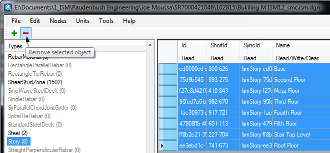

  1.  When you the "Cannot find suitable RSS level for the given ISM Curve Member." error open the repository in the ISM Editor.
  2. On the table on the left side select the Story category.
  3.  In the table on the right select all of the story levels and then click the Remove Selected Object button to delete the stories.
  4. Then go to the menu and select File>Update and update the repository accepting the deleted stories.
  5. Exit out of Synchronizer and the Editor and import your repository into RAM.
ISM will create new stories for each floor as it is imported.
