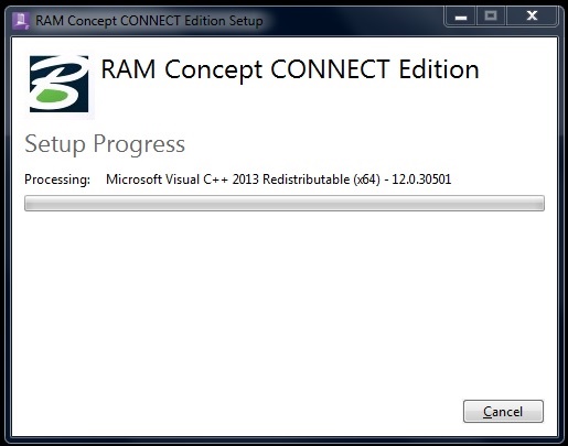

When installing Ram Concept in a 64 bit machine it checks for "Microsoft Visual C++ 2013 Redistributable (X64)" files, and in some cases presents the following message. Cancelling it puts it in a loop.
Download the 32 bit of the software and install it .
Software Download Instructions
Once done, uninstall it and then install the 64 bit version of RAM Concept.
