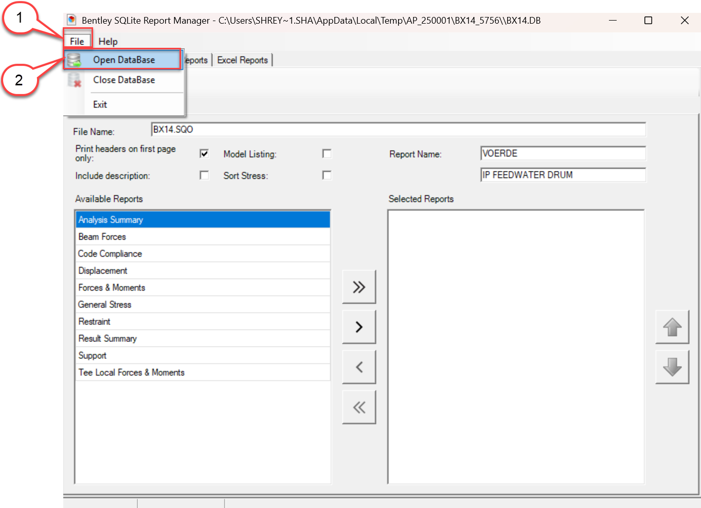

Step 7: In AutoPIPE, generate the output report from Report manager (Output/ Word or Excel) from:
Result > Report Manager > Output Report.
Step 8: In Report Manager, go to File > Open Database and select the copied database file from Step 6.
Step 9: In the Available Reports column, you will now see the sub-reports selected in Quick Report. Move them to Selected Reports and generate the report.
Step 10: You will now have an output report containing only the highlighted node points.
