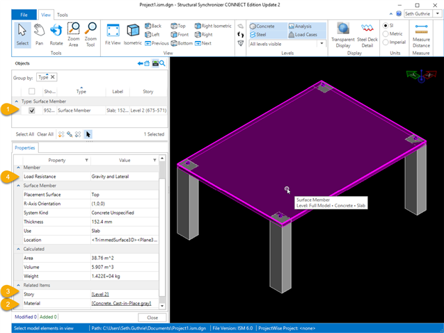

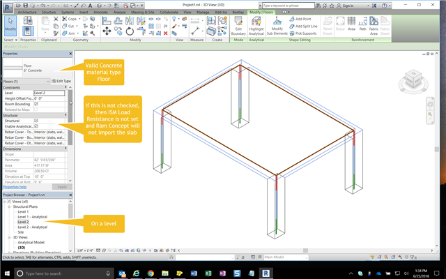

A floor slab modeled in Revit may not import into Ram Concept using ISM for various reasons.
In order for a Concrete Slab in ISM to be imported into Ram Concept that slab must be:
  1. A valid Surface Member type in a horizontal plane
  2. With a Concrete Material type
  3. Assigned to a Story, that is then selected in Ram Concept
  4. And with Load Resistance Set
Normal slabs using default Structural Family files modeled on plans typically work fine, but if with custom floor families it's possible to set up a floor slab that will not pass these tests. Then, when importing the model into Ram Concept there will be no valid slabs to import and the result will be an empty Ram Concept file.
You can also confirm the validity of the slab using the Structural Synchronizer Viewer. Select the slab and confirm these things.
