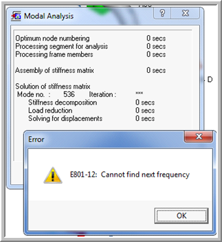

When performing a modal analysis the following error message is displayed by the program.
Error
 E801-12:  Cannot find next frequency
OK
Why and how to avoid it?
This message is not so much an error message as it is a warning but should be displayed regardless. This message is self explanatory; the program was instructed by the settings to find all frequencies up to and including a predetermined number, but was not able to reach that value. Hence the message is being displayed. It is Ok not to find the next frequency as the program was only able to calculate so many.
