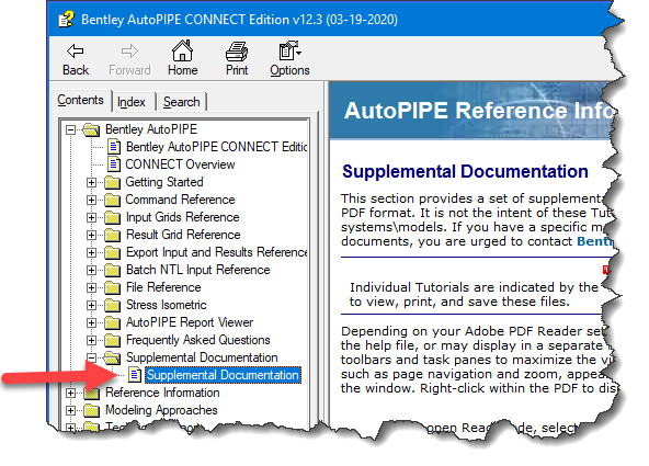

There are 2 ways of opening this location:
1. Using ribbon Contents command
a. First Start AutoPIPE
b. Next select Help Ribbon
c. Select Contents command on the far left side of the ribbon
d. Follow the screen shot below to the folder location

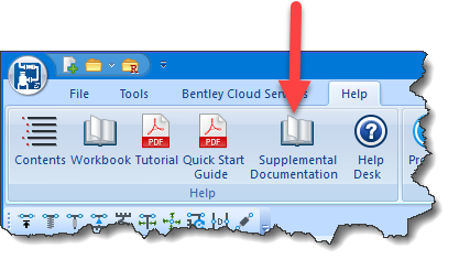

2. Using ribbon Supplemental Documentation command
c. Select Supplemental Documentation command on the far left side of the ribbon
