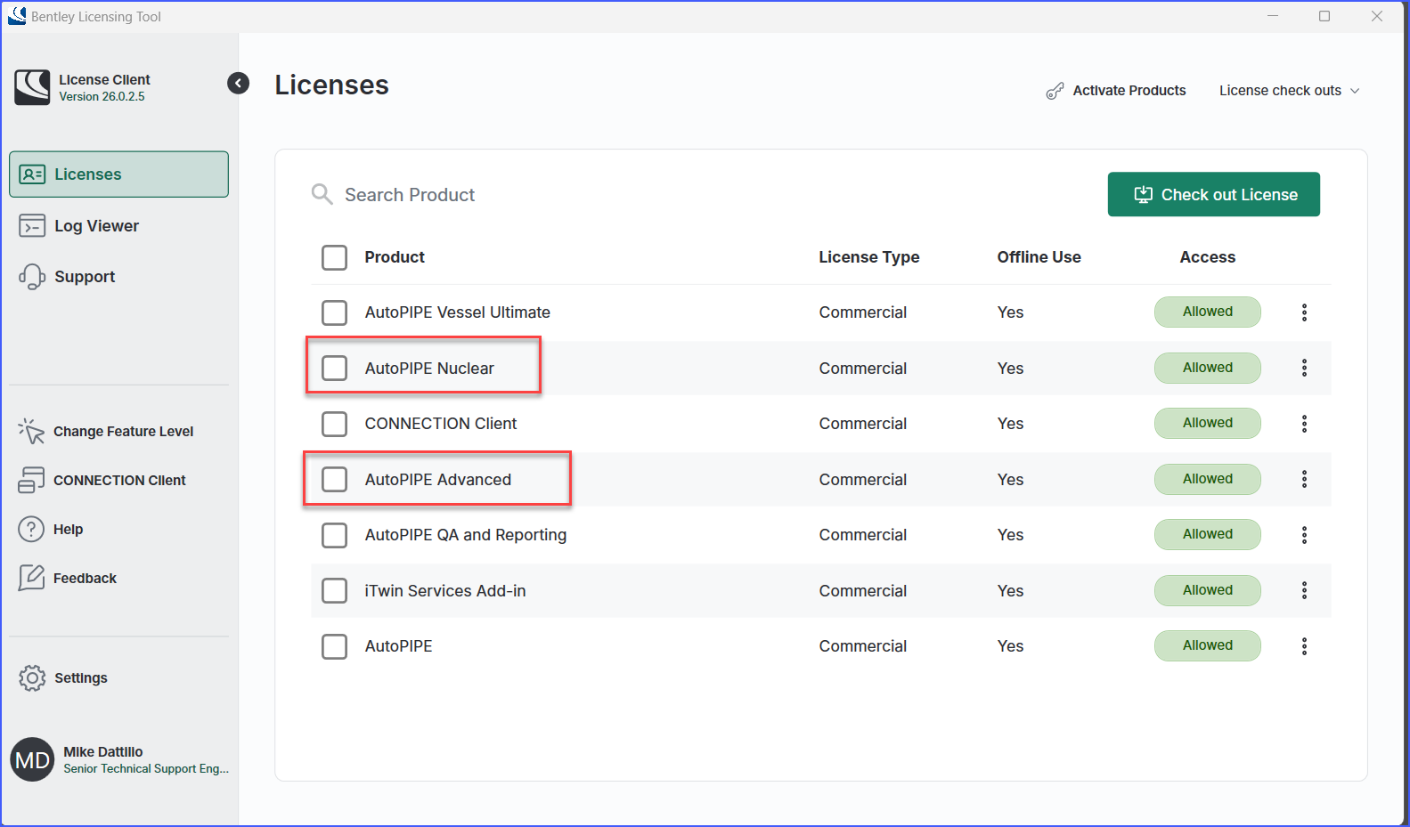

The new version of AutoPIPE Nozzle V8i 08.11.08.20 and higher

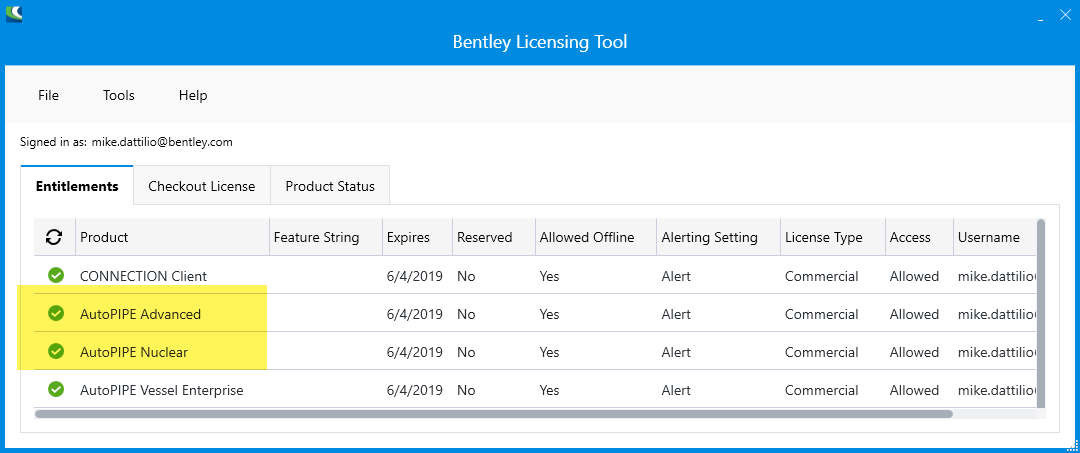

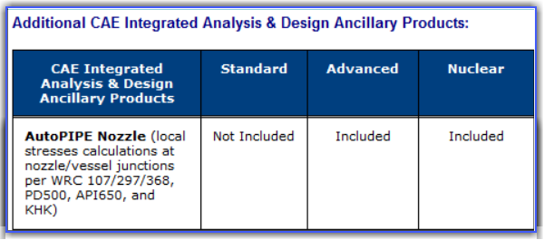

- Application no longer requires a separate license line item as seen in image above.
AutoPIPE Nozzle is now installed and licensed with owning an AutoPIPE Advance or Nuclear License.
Again, in order to use AutoPIPE Nozzle, license screen on user's computer must have a line item for AutoPIPE Advance or AutoPIPE Nuclear.
Connection Client License tool
BLT (Bentley Licensing tool)

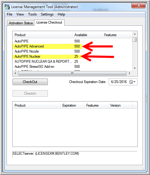

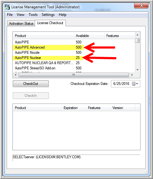

LMT (License Management Tool)

2. Set Up LMT Licensing - click here

5. Using AutoPIPE Nozzle does not count towards usage of an AutoPIPE license. The program will run so long as a valid AutoPIPE Advance or Nuclear License is apart of the User's entitlements.
6. Same as AutoPIPE, user is able to run unlimited instances of the program on a single unique computer.

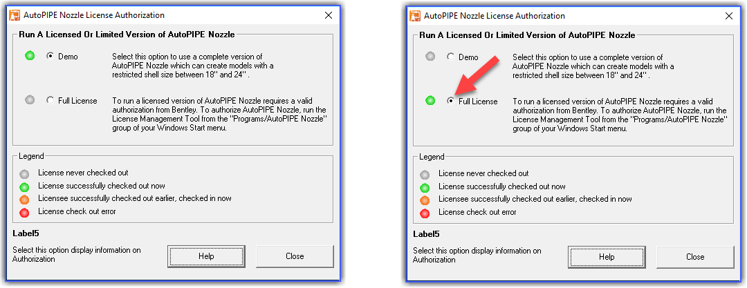

Enable Full License mode
Open AutoPIPE Nozzle from icon on desktop or from program listing, select File>  Authorize...
Press the radio button in front of "Full license", the stop light should now turn green if all steps above were verified and completed.

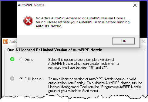

Does the following message appear:
If no, great start using AutoPIPE Nozzle:
If yes, the correct licensing is not available when selecting "Full License" mode, workaround options:

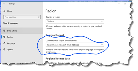

Assuming that everything above is correctly configured and the user is signed into Connection Client, there could be a problem with the computer's region selection. As a trouble shooting step set the Regional format to English. The try to see if this change allows the application to license correctly in Full license mode.
