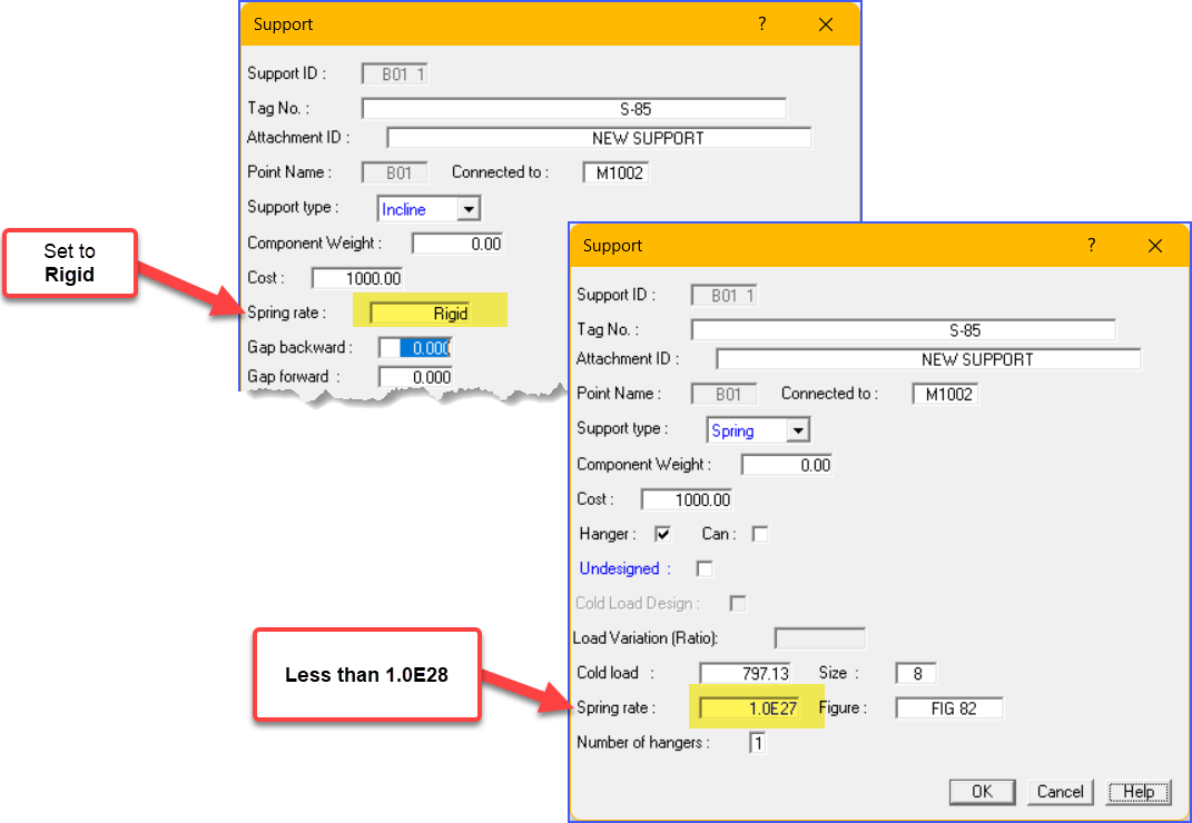

1635079: High Spring Rate/Stiffness for Supports Causes Result Grid to Crash
Description:
For models that contain supports with explicitly defined high spring stiffness, the program crashes on launching Result Grids.
Steps to repeat:
        1. Open AutoPIPE example model Walkthru.APC
        2. Analyze the model
        3. Launch Result Grid
        4. Notice that the result grid launches without any problem.
        5. Open Spring support dialog, and set its stiffness to : 1.0E29, press OK to close the dialog.
        6. Analyze the model
        7. Launch Result Grid - Notice: Program Crashes
Avoidance:
a. Open each support dialog
b. If Spring Stiffness is set to 1.0E28 or greater,  change stiffness/spring rate value below 1.0E28. or are set to RIGID.
c. Press and hold the Tab keyboard key to cycle the entire dialog
d. Press OK to close the dialog.
