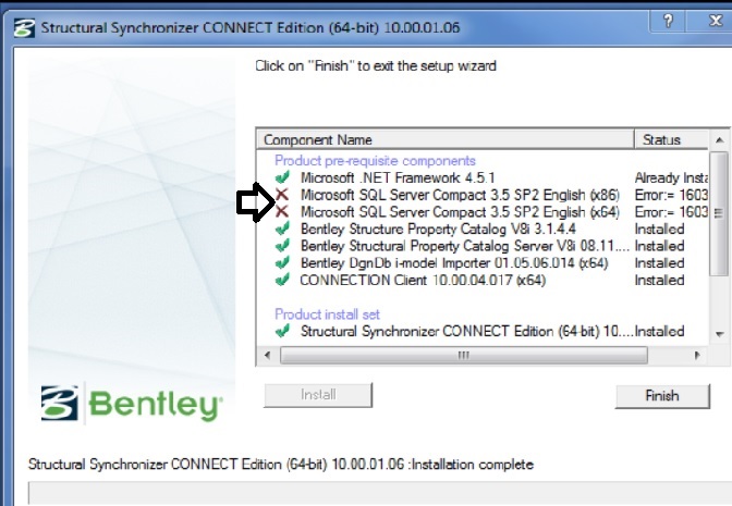

I am installing Structural Synchronizer, I get the following error messages regarding Microsoft SQL Server Compact 3.5; installation seems to complete fine.
Reason
Your machine must have some later version of Microsoft SQL Server Compact (4.0) already installed. To check this out, go to the Control Panel
For Windows 7 go to Start, click Control Panel, and then click Add or Remove Programs
For Windows 8 & 10, right-click in the screen’s bottom-left corner and choose the Control Panel from the pop-up menu, choose Uninstall a Program from the Programs category.
Please disregard the message and use Structural Synchronizer.
