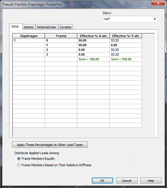

Pseudo-Flexible Diaphragm forces
In order for the program to distribute diaphragm force totals to specific frames according user defined percentages, Frame Numbers must be assigned. Once frame numbers are assigned they will appear in the Loads - Pseudo-Flexible Diaphragm Properties dialog.
For additional information see: RAMSS Pseudo Flexible Diaphragms FAQ

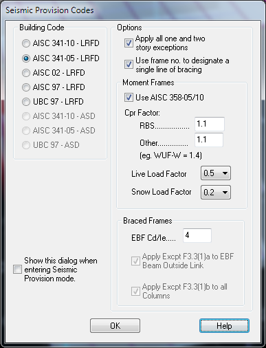

Seismic Provisions
When starting the Ram Frame - Steel - Seismic provisions mode there is an option to "Use frame No. to designate a single line of bracing"
Within the building code certain prescribed checks (e.g. for braced frames) require the engineer to perform a global check on frames that are part of a single line of bracing. The engineer can assign the same frame number to all member that are considered a single line of bracing (typically for braced frames within ten percent of the width of the structure apart) and select this option to have RAM Frame perform the required checks on single bracing lines.
