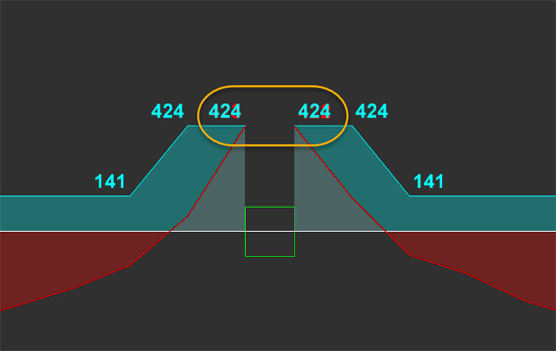

  1. PT forces were increased until the top service stress near the supports at or near the code limit. The image below shows the allowable service tensile stress (blue diagram, 6*sqrt(f’c) per ACI 318-14 24.5.2.1) and the maximum service stress (red diagram) at one of the interior columns.
