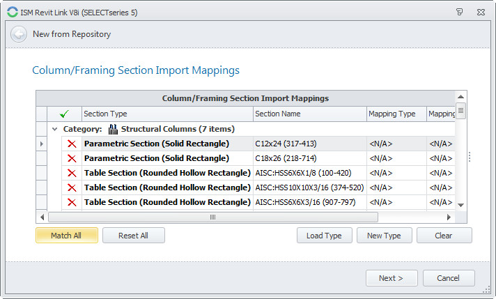

When the Column/Framing Import Mappings dialog opens the red X’s next to each of the shape types indicates they are not mapped.

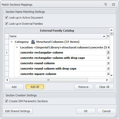

Click the Match All button and the Match Sections Mappings dialog opens.
Click the Add All button and then OK.

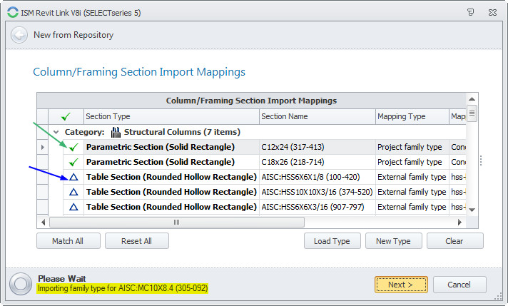

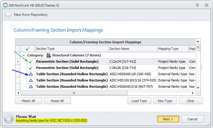

Now in the Column/Framing dialog all of the red X’s have turned to either green checks or blue triangles. The green check means the element has been matched to a shape already contained in the Revit model. The blue triangle means that the element has been matched to an external family file and that shape has to be imported before it can be used in the model.
 Click Next and the shapes begin to import. Once the shapes have been imported the Mapping Type changes from External family type to Project family type.
