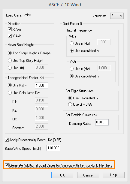

How are reverse direction lateral loads handled when using tension-only members?
When defining program generated lateral loads, like wind or seismic loads, there is an option to "Generate Additional Load Cases for Analysis with Tension-Only Members" that should be checked when the model includes any tension-only braces. Using this option leads to a load case in the positive direction, say west to east, and another load case in the negative direction, east to west.  For each of these load cases, different members may be active in resisting the load so it's important to perform a separate finite element analysis of each direction.

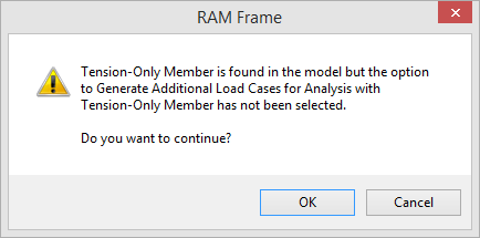

If the model includes tension-only braces, but this option is not checked then a warning is generated.

Note, for models with user defined loads or nodal loads the same rules apply; if there are any tension-only braces in the model, then user loads should be created for both directions.

If a brace that was specifically assigned to be tension only is going into compression, that usually indicates a problem with the load combinations. For models with tension only members, the load combinations should never include negative terms in any load combinations (generated or custom). If there is a combo with a negative term, the resulting brace force could be compression and the warnings above will occur.
Consequently, any model with tension only members requires one lateral load case in the positive direction and another load case in the opposite direction if all the braces are to be correctly evaluated. For program generated loads, there is a check box for "Generate Additional Load Cases for Analysis with Tension-Only Members" that can be selected to do this automatically, but for user defined story forces or nodal loads, an additional case for the reverse direction must be manually input.

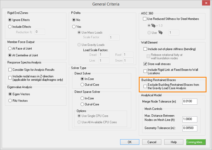

An enhancement was added in RAM Structural System v14.06, which should resolve the problem with large displacements and instability errors. Beginning with this version, P-Delta effects will not be included when analyzing gravity load cases with the special tension-only analysis. This is a reasonable implementation since in virtually all cases the P-delta moments due to lateral sway caused by gravity loads is extremely small. P-Delta effects will still be considered with the lateral load cases. More on this can be found in the v14.06 release notes, which are located here: V14.6 Release Notes.
Starting in version 14.07 another option was added to the RAM Frame General criteria for Buckling Restrained Braced Frames (BRBF). If the option to "Exclude Buckling Restrained Braces from the Gravity Load Case Analysis" is checked, the same problem noted above for tension-only braces may occur.
