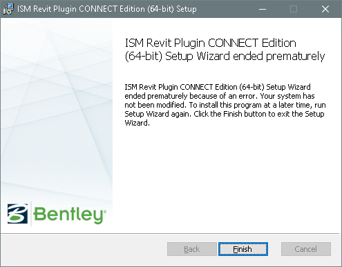

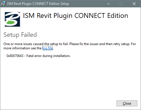

ISM Revit plugin CONNECT Edition version 10.03.00.08 fails to install. The setup terminates indicating the following:
The problem occurs where Microsoft .NET 3.5 is not installed.

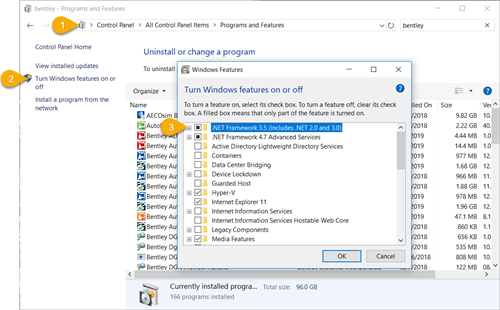

Installing .NET via Control Panel - Programs and Features - Windows Features enables the installer to function properly.
