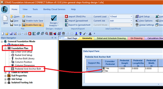

Pedestals
In practice, pedestals are generally present in the case of footings that support steel columns. The pedestal is the block of concrete that supports the base plate beneath the column, and hence has a slightly larger plan dimensions than the base plate.
If a pedestal is present, the engineer can specify that information through the Pedestal and Anchor Bolt tab of the Foundation Plan page as shown in the next figure. Note that the Anchor bolt data is not required to be specified, nor is the program able to use that information at this time.
If the “Yes” option is chosen, then, the forces from the column are assumed to act at the top of the pedestal. This is the point usually considered as a support for the superstructure. Thus, the support reactions for the superstructure analysis, which are the algebraic opposite of the loads transferred to the foundation from the columns, are assumed to act at the top of the pedestal.
If there are lateral forces FX and FZ acting at the top of the pedestal due to wind load, seismic load, or other reasons, those forces are assumed to produce additional moments at the at the base of the footing in the following manner:
MX at footing base = MX at column base (from the column reaction) + FZ * Lever Arm
MZ at footing base = MZ at column base (from the column reaction)  - FX * Lever Arm
where Lever Arm = Pedestal height plus the total thickness of the foundation

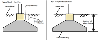

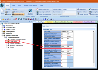

Top of footing and specifying the height of soil
For tapered footings, one of the input terms that the engineer is required to provide is the Depth of Soil Above footing. The height of soil to be used in the calculations is determined by the program from this term, in the following manner.
The calculation requires the knowledge of which part of the footing is considered to be the datum position.
If the term Type of Depth is set to Fixed Top, the datum line is the top of footing.
If it is set to Fixed Bottom, the datum line is the bottom of footing.
The height of soil is calculated accordingly, as shown in the next figure.
For stepped footings, the term used is “Footing Embedment Depth”.
It has the same meaning as “Depth of Soil above footing” described for the tapered footing. The same rules described above are used for determining the height of soil for the stepped footing.

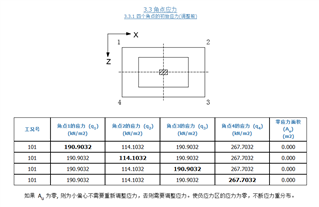

Base pressures are first calculated using a rigid footing approach. In the Help manual, the section titled Calculating Isolated Footing Sizes provides the details of the approach used for such footings. A similar approach is used for combined footings too. The procedure used by the program to calculate soil pressures for axial load + biaxial bending caters for the possibility of partial uplift (partial loss of contact).
For any service load case, the footing is considered safe if all of the following conditions are satisfied.

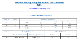

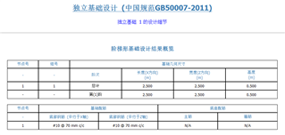

 Calculation report
For a successful design, a calculation sheet is displayed containing the details for the checks mentioned above, and the governing load case for each check. For a failed design, the cause of the failure has to be interpreted by reading the messages displayed in the Output Pane, which is the panel below the drawing area.
The report can be obtained in either Chinese or English. This choice is available from the “Report Customization” dialog box.

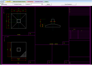

Drawings
Drawings of the foundation plan and layout are also produced.

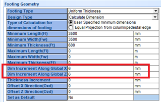

Modification to the parameters used in length and width increment for footing sizing
In past versions of SFA, for isolated footings, the Footing Geometry page had two options known as
as shown in this figure.
This has now been replaced with the following 2 options
which represent the amount by which X or Z dimension of the footing should be incremented by for each iteration (Dim stands for Dimension).
As a result of this change, two of the options available previously called
(if the design type was set to Calculate Dimension) are no longer available. Fixed Width can be simulated by setting the Dim Increment Along Global Z to 0.0, and, Fixed Length can be simulated by setting the Dim Increment Along Global X to 0.0. But note that both cannot be 0.0 simultaneously if the design type is Calculate Dimension.

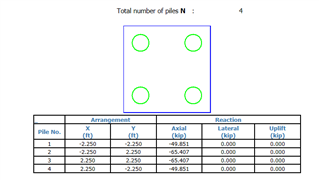

  5. A representative sketch showing the pile arrangement is henceforth included in the calculation sheet for jobs where a pile arrangement is calculated prior to the design of the pile.
  6. For SFA files which were created using past versions, the engineer will have to re-generate the pile arrangement and re-run the analysis if he/she wishes to see the sketch appear in the calculation sheet.
