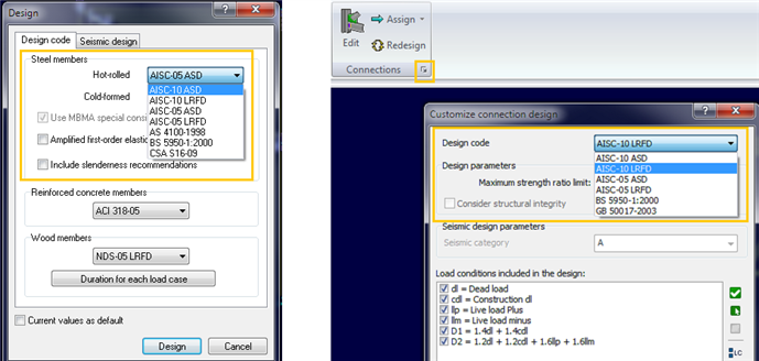

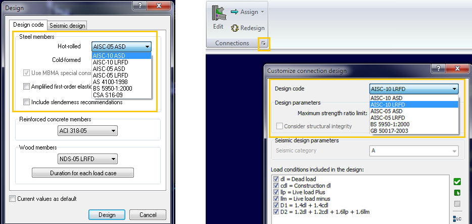

Steps to Resolve
Install Ram Connection 10.0 or later in order to change design codes for existing joints. Note, changing countries may still invalidate connections where there is not an equivalent connection type in both codes.
In all three cases, the design code must be set to the desired code and then new connections assign to the joints. The following article shows where to set the codes: Ram Connection Codes
