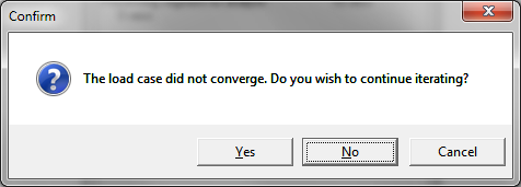

When analyzing a model the following occurs:
Confirm
The load case did not converge. Do you wish to continue iterating?
Yes No Cancel
What should I do?
Selecting YES: The program will re-run the analysis for more iterations in hopes of converging below the non-linear tolerances specified.

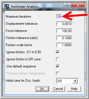

The default number of iterations is 30, If it was determine that 31-99 iterations enabled the analysis to converge, make this a permanent change by changing the Nonlinear analysis> Maximum iterations settings, as shown below
Then each time an analysis is performed it will use the updated number of iteration thus reducing likely hood that the message above will be displayed.

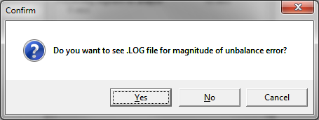

Selecting No: Stops the analysis procedures and presents the following:
Confirm
Do you want to see .LOG file for magnitude of unbalance error?
Yes No Cancel
Selecting Yes: AutoPIPE Viewer is automatically displayed with the *.LOG for review.
Selecting No: The dialog is closed and user is able to enter the next AutoPIPE command.
Selecting Cancel: The dialog is closed and user is able to enter the next AutoPIPE command.
The first step for any model with non-convergence use slightly liberal tolerances to allow for convergence may resolve the non-convergence issue.
a. Increase the force tolerance
b. Increase the displacement tolerance (increase the displacement tolerance by factor of 10 until it converges, then ease off the tolerance until you avoid the errors)
Some more converging solutions for buried piping are to first try using nonzero K2 values in order to avoid unlimited displacements. Using larger K2 values temporarily (K2=K1/1000 or so) can help you see if P1 values are sufficient by checking displacements. By setting K1, K2, P1 to 0.01 N/m and 0.001 M/mm/mm, the model should converge with no problem
May need to add concentrated or distributed weight to submerged pipe to prevent it from uplifting (in practice concrete mats are added in some cases
Try using V-Stops at a reasonable spacing (that will make it pass the sustained stress check). You may have to use large friction factors (0.5 to 1.0) for these supports
Under certain circumstances, when 2 analysis set should be the same but are different may be directly related to different number of iterations and tolerance settings that are too wide. Tightening up the tolerance may help the results become more consistent,
