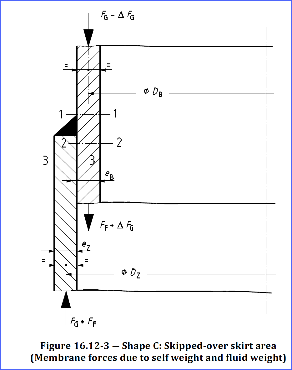

49. How to add a structural shape C for skirt attachments as per EN 13445-3 16.12.3.4 (Figure 16.12-

How to add a structural shape C for skirt attachments as per EN 13445-3 16.12.3.4 (Figure 16.12-3) and AD2000 S3/1 ?
Modeling of skirt arrangement as per EN 13445-3 16.12.3.4 (Figure 16.12-3) and AD2000 S3/1 is not available in current version.
We are working on implementing this new feature in our coming version. A new feature (640033) has been logged and should appear in a future version of the program.
