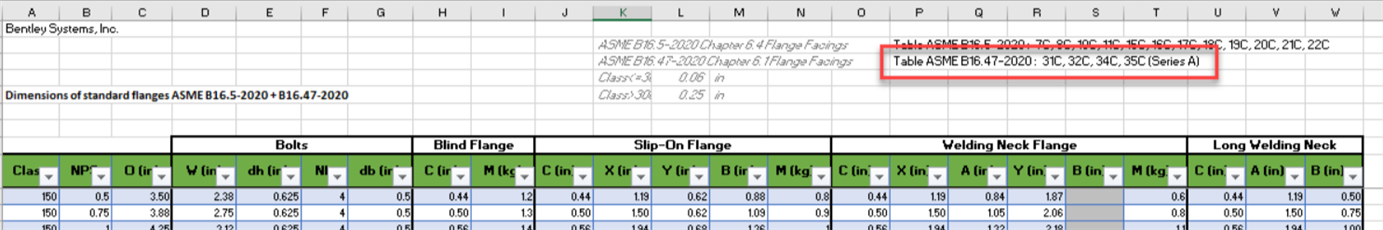

But user can modify the customization file flangeAS.xlsx to get the desired flange dimensions.
Find the file in directory where software files are present. Generally customization file can be found at C:\Users\Public\Bentley\AutoPIPE Vessel\AutoPIPE_Vessel_43\Config.
