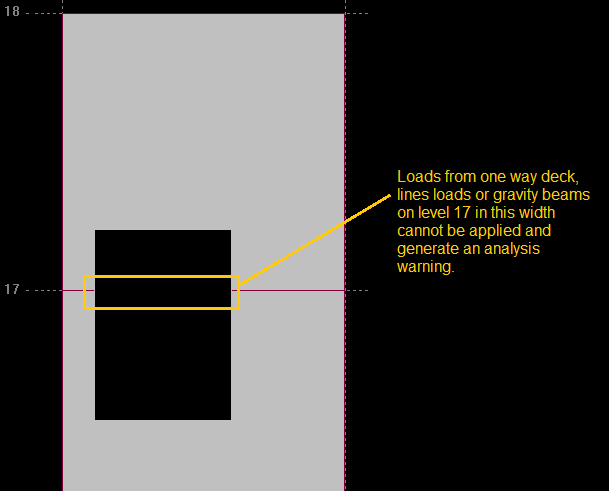

2. Loads on walls partially ignored. This happens when an opening in a wall crosses a story line when there are floor decks/loads or line loads modeled on the floor that is met or crossed. The plan view does not show these openings so the elevation view should be used to review these conditions. Note, it’s only the loads from one-way decks, lines loads and wall self-weight affected by the warning, loads from meshed 2-way decks are still considered. Wall self-weight is affected because wall weight is calculated for the wall segment and applied as a line load at the top of the wall.
