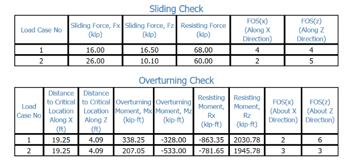

Sliding and Overturning Checks for Mat Foundations
For mat foundations on soil springs, the following additional checks are now performed for all the service load cases included in the job. Factors of safety are computed for the following:
  1. Sliding along the global X axis
  2. Sliding along the global Z axis
  3. Overturning about an edge or a corner about an axis that is parallel to global X
  4. Overturning about an edge or a corner about an axis that is parallel to global Z

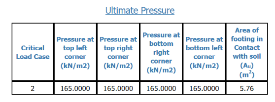

Additional Conditions for Checking the Safety of Isolated Footings
A facility has been added that allows the user to set two additional conditions to determine the safety of isolated footings:
  1. Permissible Soil pressure for ultimate load cases
  2. Minimum required contact area for ultimate load cases
Both of these options are now included on the Cover & Soil page for Isolated Footing jobs.
The maximum soil pressure that is reached and the least (smallest) area in contact from among all the ultimate load cases is now reported in the calculation sheet.
