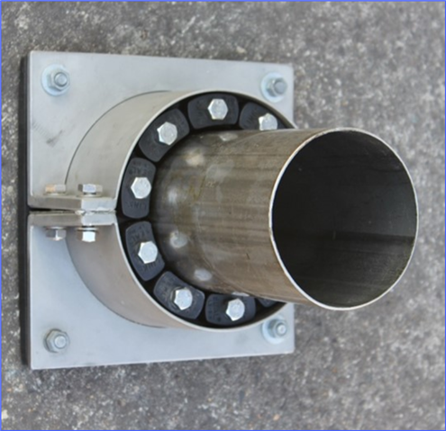

Pipe Seal or  Link-Seal (hydrostatic sealing system of rubber applies secure, consistent pressure around pipes)
AutoPIPE modeling approach for a Link-Seal:
Step #1: Assumptions, Non-Linear analysis, Pipe slides in Link-Seal but does not come into contact with the hole
Support #1 - Guide (restrains vertical & lateral pipe movement against Link-Seal)
Stiffness = Link-Seal stiffness after being installed (suggest contacting manufacture for valid values)
Gaps = 0.00 in all directions
Friction =  Pipe material on rubber
Step #2: In your opinion does a Link-Seal have a certain breakaway force before axial movement?
If No, go to Step #3
If Yes, insert axial Incline support
Ultimate force gap = enabled
Breakaway force = calculate and insert value
Assuming that after breakaway, axial pipe movement is modeled on support #1 above, therefore remaining dialog stiffness and phase settings remain 0.00.
