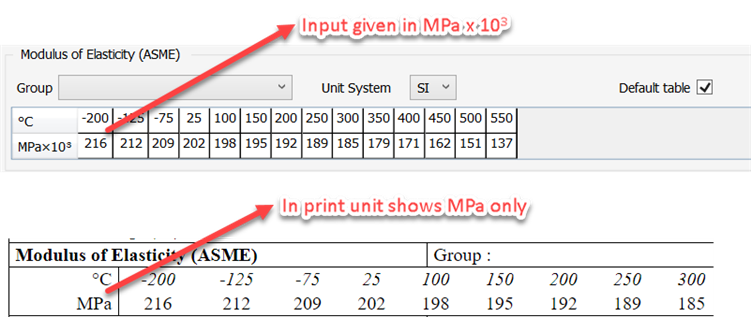

When printing data for a material, young's modulus values printed are not same as input values,
Product(s): AutoPIPE Vessel
Version(s): ALL
Area: modeling
Date Logged
& Current Version
May 2023
43.01.01.011
When printing data for a material, young's modulus values printed are not same as input values. for example in SI Unit, values entered are MPa x 103 (GPa) but when we print it shows MPa only.
A bug has been created against this issue and development team is working on this.
This issue will be fixed in our future release.
