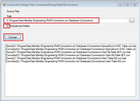

RAM Connection v8.0 connection databases need to be converted to a new format. The following should only be completed if the user has customized databases:
Find the database converter (DataFileConversor.exe) located in the following location:
English Version - C:\Program Files (x86)\Bentley\Engineering\RAM Connection.en
Spanish Version - C:\Program Files (x86)\Bentley\Engineering\RAM Connection.es
Double-click on the file to run the executable. The dialog below will appear:
In the path box, choose the new location of the Connections Database:
English Version - C:\Program Files (x86)\Bentley\Engineering\RAM Connection.en\Connections
Spanish Version - C:\Program Files (x86)\Bentley\Engineering\RAM Connection.es\Connections
Check the box for "Include Sub Folders."
Click on the Convert button to convert the files.
