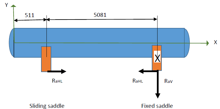

12. What are the Longitudinal loads on saddles in AutoPIPE Vessel?
Cases without earthquake and without longitudinal acceleration (motion)
Displacement :
Loads :
For the Sliding Saddle:
For the Fixed Saddle:

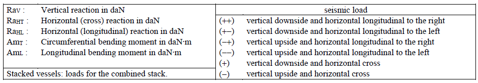

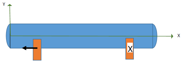

Cases with earthquake or with longitudinal acceleration (motion)
Depends on the sense of the longitudinal action due to the earthquake or the longitudinal acceleration for motion.
According to the code here after:
