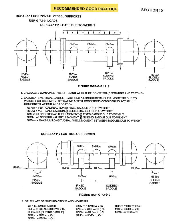

AutoPIPE Vessel employs a simplified and highly conservative analysis method recommended by TEMA 8th Edition, section 10, to calculate saddle supports reactions for a horizontal vessel.

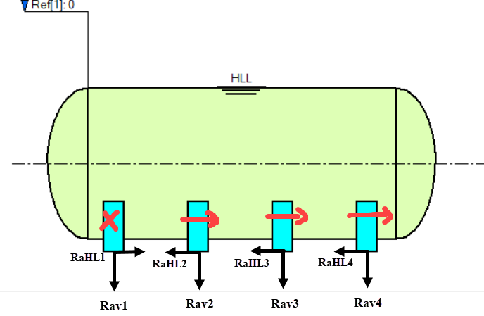

How Horizontal (longitudinal) reaction (RaHL) is Calculated?
Refer below vessel configuration to proceed further:
Follow the below steps to calculate the horizontal longitudinal friction forces on saddles,

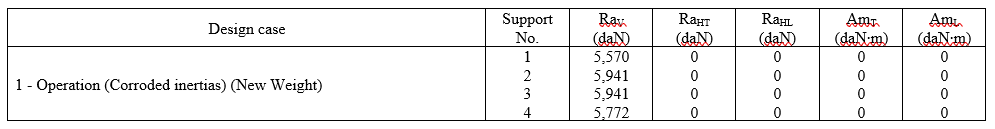

    1. Step 1: First change the friction factor at saddle base to zero and perform the calculation
    2. Step 2: Open the summary of foundation load and note down the vertical loads (Weight of the vessel),
Here there is no negative vertical load since no horizontal load which can create the moment.

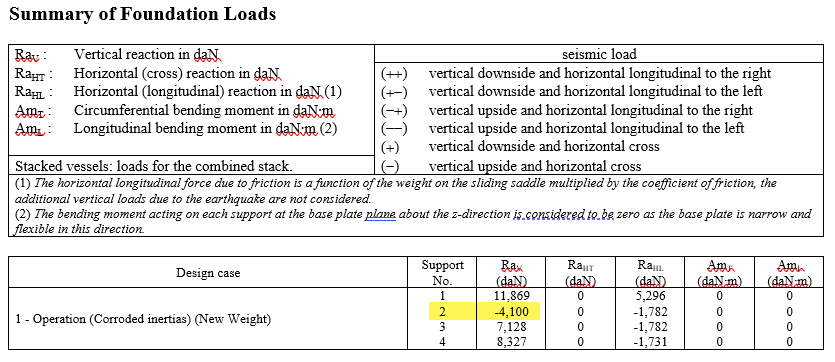

    1. Step 3: Now change the friction factor value to 0.3 and perform the calculation.
    2. Step 4: Open the summary of foundation load and note down the loads,

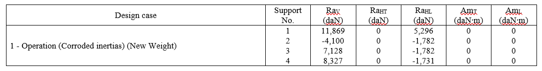

    1. Step 5: Verify the horizontal loads. Note that in this calculation we need to consider the vertical load on saddle which are calculated with friction factor of zero.
                RaHL2 = Rav2 * Friction factor = 5941*0.3 = 1782 daN
                RaHL3 = Rav3 * Friction factor = 5941*0.3 = 1782 daN
                RaHL4 = Rav4 * Friction factor = 5772*0.3 = 1731 daN
                Since system is in statically equilibrium condition sum of all horizontal loads are equal to zero.
          RaHL1 = RaHL2 + RaHL3 + RaHL4 = (1782+1782+1731=5295 daN) but in opposite direction of other loads on rest of the saddles.
    1. When the longitudinal loads exist, the vertical loads are modified. These modified values are due to the moments.
Why there is negative vertical load at the saddle support?
It is essential to understand that one saddle must remain fixed. This fixed saddle serves to counteract all horizontal longitudinal forces arising from differential thermal expansion. As a result, additional moments are introduced at the saddle location on the equivalent beam.
In example model, the first saddle is fixed while the remaining saddles are sliding. Due to this configuration, the moment at the first sliding saddle is significantly high, resulting in negative vertical loads.
