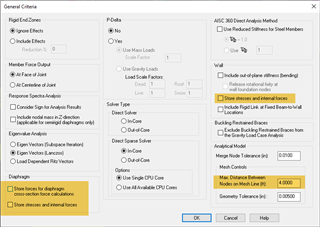

Is there a maximum file size?
As of version 17, the Ram Manager utilizes a 32 bit zip control to compress the working files into a single zipped .rss file. This control is limited to 4GB. Should you have a file that exceeds that limit it may not save completely, giving the "Could not unzip . . . . . " error message. At that point you should Save as Archive to save the input without results and then try to reduce the file size, e.g. by increasing the mesh size or changing criteria to not save some of the results, e.g. wall stresses.

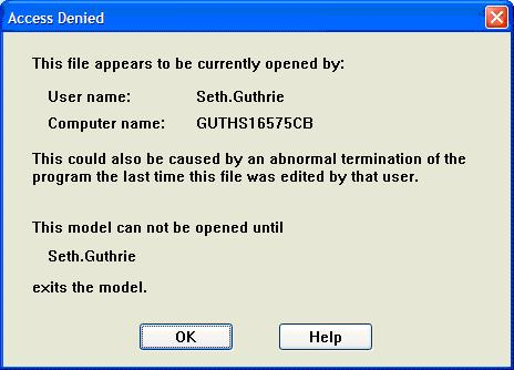

When I open a model I get a warning, “This file appears to be currently opened by: User Name…”
If the listed user really is in the file, they need to exit the program normally to release the model so that you can open it (RAM SS models do not allow for concurrent use).
If that user is not currently in the file or unavailable, you should navigate to the directory where the model is saved and look for a file of the same name with the file extension “.usr”. This is a lock file that was created when the user last accessed the model. The .usr file is normally deleted when the model is closed, but if the program terminated irregularly, the file might persist. Simply delete the .usr file and the .rss file can then be opened.

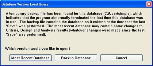

When I open a model I get a warning, “A temporary backup file has been found for this database (path to file), which indicates that the program abnormally terminated…”
If you select the “Most Recent Database” you are telling the program to reload the files from the working directory which should be the same as they were just before the crash. In such cases, we suggest that you immediately use the file – save-as feature to turn this into a new model file.
Clicking “Backup Database” deletes the working files and restores the files from the saved model whenever it was last saved. “Cancel” leaves everything alone. If your not sure when the last save occurred, click cancel and then check the modified date of the model file through an explorer window before returning to pick either option.
Starting with version 14.06 an additional backup file is created for models that crash and are then re-opened. A copy of the rss file with the extension .ssr is created if you reopen a model that is already expanded to the working directory indicating a previous crash or incomplete closure. Like the .backup file, the .ssr file can be renamed with a .rss extension to restore that version of the file.

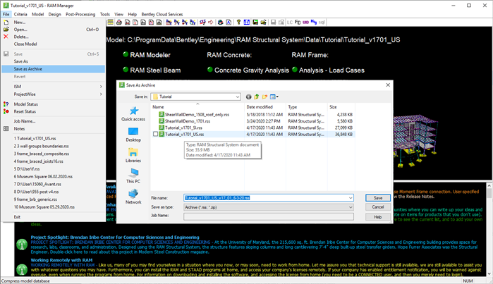

How can I reduce the size of my files?
Starting in version 17.01, use Ram Manager - File - Save as Archive to create a backup file without analysis results. The save-as dialog will appear and the default file name with match the original with the version and date added as a suffix.
For older versions, see below:
A RAM Structural System model (file.rss) is already a compressed zip file, but the size of that file can become quite large, especially when the analysis and design results are saved with the file. In RAM Manager under the File menu is an option to ZIP the model. When zipping models using that command you will have the opportunity to purge the model of some unnecessary results (which can be regenerated later just by running the file again). The optional results are:
