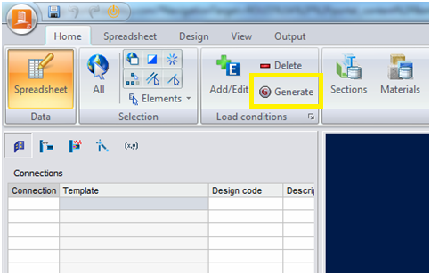

Step 1
Click on the Generate button in the Home menu - Load Conditions tool bar.

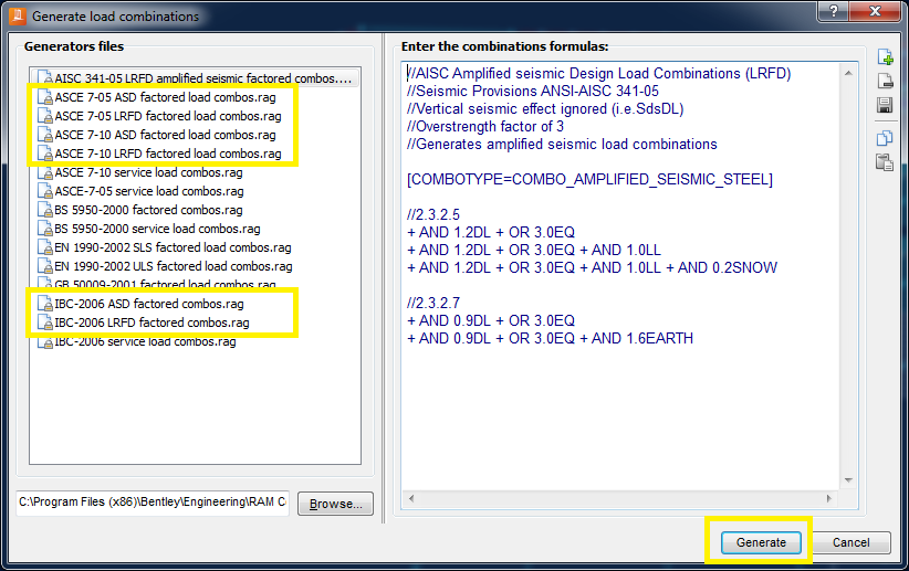

Step 2
In the Generate Load Combinations dialog, select a factored load combination that matches the design code that is selected and then click on the Generate button. The factored load combinations used in the United States are marked in the screen capture below.

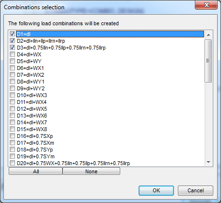

Check the boxes for all load combinations that include gravity load cases only. Combinations that include gravity and lateral load cases do not need to be selected. These combinations have been imported from RAM Frame and include the notional load cases. Click the OK boxes to close the dialogs and generate the load combinations.
