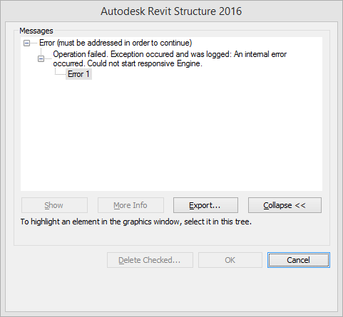

Error - Could not start a responsive Engine
  Product(s): Structural Synchronizer
  Version(s): CONNECT edition
  Area:  General; Installation
 Problem Description
When trying to perform an ISM function, like Create Repository, from and ISM enabled application, the process fails with a message indicating, "An internal error occurred. Could not start a responsive Engine."
Reboot the PC. The problem may involve the current state of the .NET framework which was affected by another installation. Rebooting the computer generally solves it.
