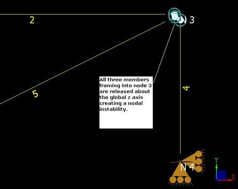

Beam, column and brace intersections.
When multiple members frame to a single node, it is acceptable to release some, but not all of those members. If the beam, column and brace are all released at the same node, then the problem is the same as case 1 above. At least one of those members should be fixed ended. In most situations, it is the column top that should remain fixed to the node.

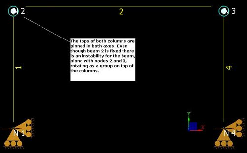

Releasing the tops of columns.
In this case we have a fixed ended beam setting on two columns, both of which are released at the top node. This case differs slightly from Case 2 because the nodes are fixed to the beam and not themselves instable. The problem is that the beam along with both top nodes can spin as a group on top of the columns similar to a log on water. This is an example of why it is usually better to keep the tops of the columns fixed and release the beams.

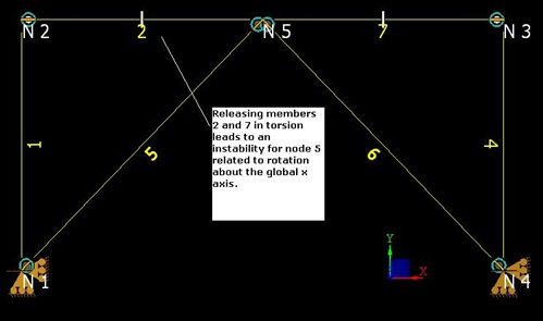

Torsional releases
It's hard to envision a realistic connection that allows a member to spin or swivel, but most FEA application do allow member torsional releases. A general rule is to leave the member torsion fixed except in a situation where member rotation really is free. The most common problem occurs in a chevron brace configuration where the beam is two finite elements. If each beam half is released in torsion, then the node at the top of the braces is instable.

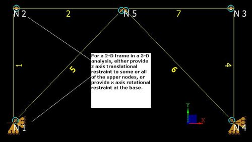

2-dimensional frame in a 3-dimensional analysis
Often it is desirable to analyze a 2-dimensional frame using a 3-dimensional analysis. In some applications there is plane frame option that can be used to ignore the deflection out of plane (e.g. z axis) or rotation about the other axes, but if not, the frame can generally be stabilized one of two ways.

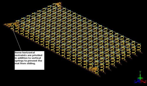

A certain number of nodal restraints are always required to keep the structure as a whole from moving. Another common case is one where a shell or mat foundation is supported by a series of vertical springs. While that is stable in relation to vertical loads, some mechanism must be provided to keep the mat as a whole from sliding around like a skateboard. This is generally achieved through the use of horizontal springs in addition to the vertical springs, or by restraining the translation of a node (or line of nodes) along the edge of the structure.

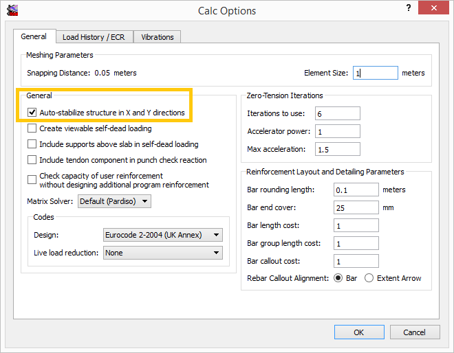

This is a common problem in Ram Concept if a vertical resistance area spring is the only support for the structure. When there are no lateral loads, you might get away with providing an area spring with only vertical stiffness, but when there is any external load applied in the plan directions, some resistance to sliding must be incorporated into the model. Many users enter this as small R and S axis resistance in the area spring which is analogous to friction acting on the soffit of the mat. Line springs or line supports on the slab edges (at mid depth) are another approach. Ram Concept also has an option under Criteria - Calc options to "Auto-stabilize structure in X and Y directions" which is another option to provide stability, but this should only be used for structures without lateral loads.

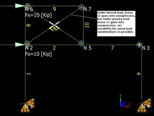

Using tension-only members or compression-only springs
When a model utilizes non-linear members or springs most FEA applications iteratively solve for each load case and load combination. On each iteration, if a tension-only member is found to go into compression, that member is thrown out of the analysis and a new iteration is started. If too many of the members go into compression, the frame or structure as a whole can become instable.
There are a couple of ways to effectively deal with such a situation
