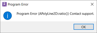

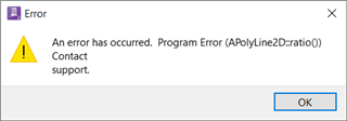

When generating design strips, one of the following errors below is displayed. The errors prevent the analysis from completing.
1. APolyLine2D::ratio()

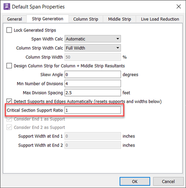

Both errors are associated with the Critical Section Support Ratio parameter. One workaround is to uncheck the box for "Detect Supports and Edges Automatically" which disables that option.

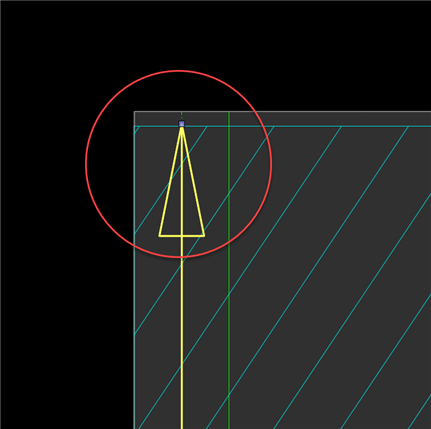

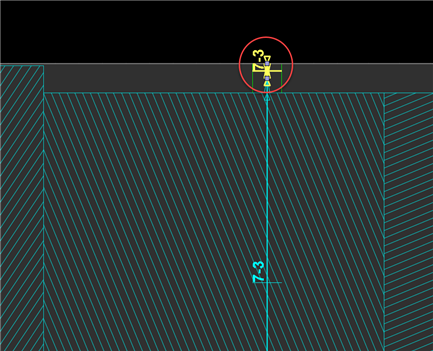

The APolyLine2D::ratio() error occurs when both ends of a span segments are within a support shape. This most often occurs when a span segment is modeled parallel to a wall and one of the span segments is snapped just inside the wall end (see first image below) or at a perimeter columns where the column face coincides with the slab edge and a short span segment is modeled from the column centerline to the slab edge (see second image below).
