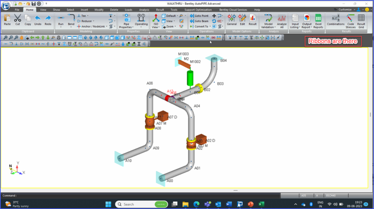

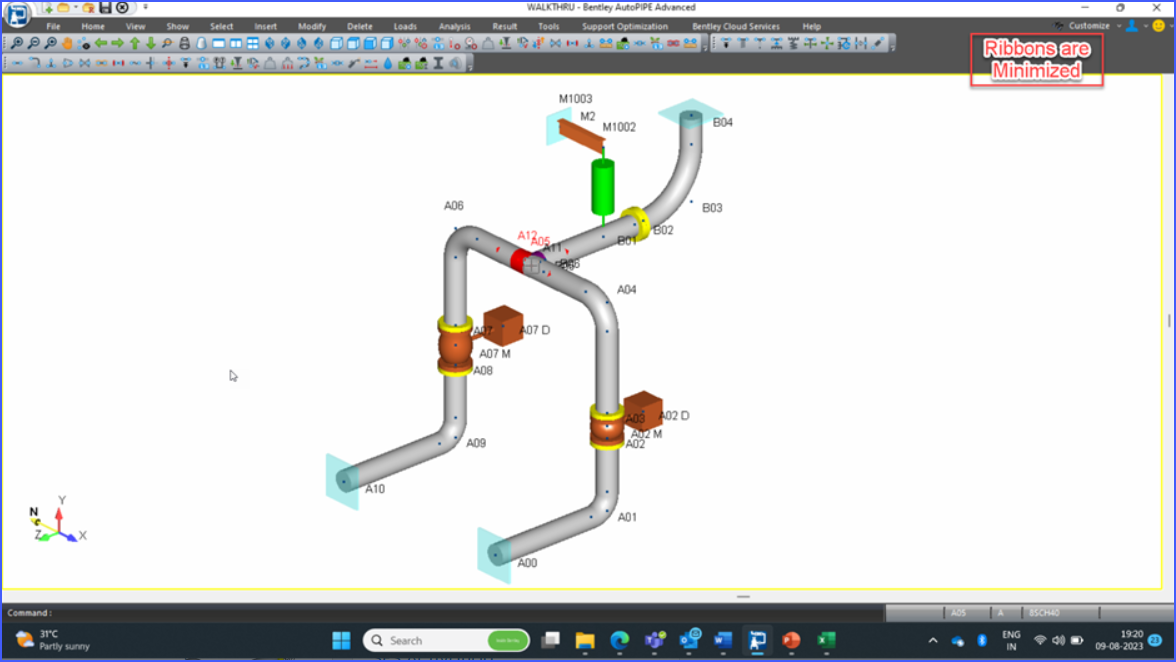

The ribbon for each menu hides when I click some icons. How to get back this ribbon tab on the screen?
Ribbon can be minimized by just Right click on the Ribbon tab Area and Click on Minimize the Ribbon.
Similarly, we can get back the Ribbon tab by Right Clicking on the Ribbon Tab are and uncheck the Minimize the Ribbon.
See the video demonstration below for the reference.
