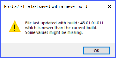

The following message is displayed when opening a file:
File last updated with build xxx which is newer than the current build. Some values might be missing.
Why and how to avoid?
In one particular case, the allowable material stress is gone. The model was opened and saved with version 43.01 and then opened and saved with a previous version (42.04). A warning message indicated that this operation can lead to the loss of data because backward compatibility is not supported, there is a risk of corruption of the model, hence the loss of the admissible stresses of the materials. To repair the model, one must reset the materials: select a different material revision year, validate (OK button), reopen the dialog box and return to the previous material revision date.
