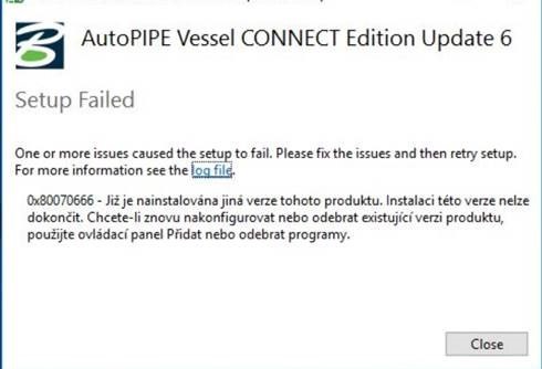

The following was displayed when installing the application:
Setup Failed - 0x80070666
why and how to avoid?
This issue is related to a known issue (875675) when Visual Studio C++ 2015 Redistributable. This issue will be fixed in the next release,
Follow steps below.
Step #1: Uninstall manually all Visual Studio C++ 2017 Redistributable ( Note the version )
Step #2: Install AutoPIPE Vessel
Step #3: Install all Visual Studio C++ 2017 Redistributable AGAIN ( With the same version )
