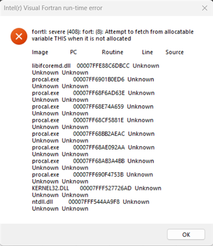

The following error appears when AutoPIPE Vessel start strength calculations,
forrtl: severe (408): fort: (8): Attempt to fetch from allocatable variable THIS when it is not allocated.
Why does this happen and how to avoid?
When user select Apply DIN 18800 Part 4 option, strength analysis crashes.
There is a bug in software, A bug has been created and development team is working on this and will be implemented as soon as possible.
Workaround for this issue is to uncheck the option Apply DIN 18800 Part 4 and model will perform the strength calculations successfully. Refer below snap.
