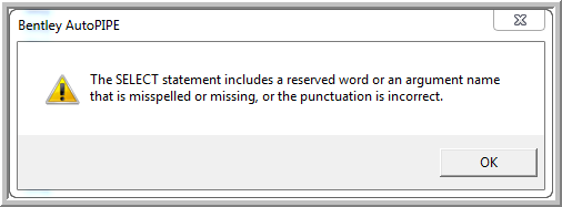

The following appears when reviewing the results grids:
Query is too complex.
OK
And then
The SELECT statement includes a reserved word or an argument name that is misspelled or missing, or the punctuation is incorrect.
OK

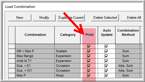

The problem is occurring due to the number of printable combinations exceeding 254. This is a database related limitation. AutoPIPE 12.04 and lower cannot specify more than 254 comparison cases as criteria in result grids while querying the database.
This issue (644882) is general and is repeatable in a fresh model, if more than 254 combinations are created with print flag ON.
The avoidance to the problem is to limit the number of combinations using 'Print' flag.
This can be performed using Non-code combination tab of Tools->Combinations dialog. Unchecking the "Print" flags for some combinations, so that the total number of combinations with print flag enabled not exceeding 254, the issue can be avoided.
